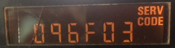

So Serv icon stays illuminated and lists the following codes
I see a lot of photos but not one of them with the SERV CODE icon lit indicating that the Code on the screen is Active. Can you possibly try again please, starting with a photo of the Monitor Panel taken with the engine idling showing the SERV CODE icon lit up. Having the engine running will remove the likelihood of any spurious low voltage Codes that may be present when the engine is stopped.
The image below shows an Active Code.
Each Code will appear in two consecutive screens as follows MID (030, 081), CID (110, 248, 621) and FMI (02, 08).

Nige Apologize for delay… I show one active code with service icon illuminated . Let machine run for approx 5 min to eliminate any possible low voltage codes .IMG_2463.jpegIMG_2462.jpeg

OK, so now we are getting somewhere. You have 819 F02 which relates to the transfer of information to/from the principal Monitor Module and the Quad Gauge Module and the Speedo/tacho (if equipped) module.
See the attached troubleshooting procedure. Also check your message inbox for an electrical schematic.
