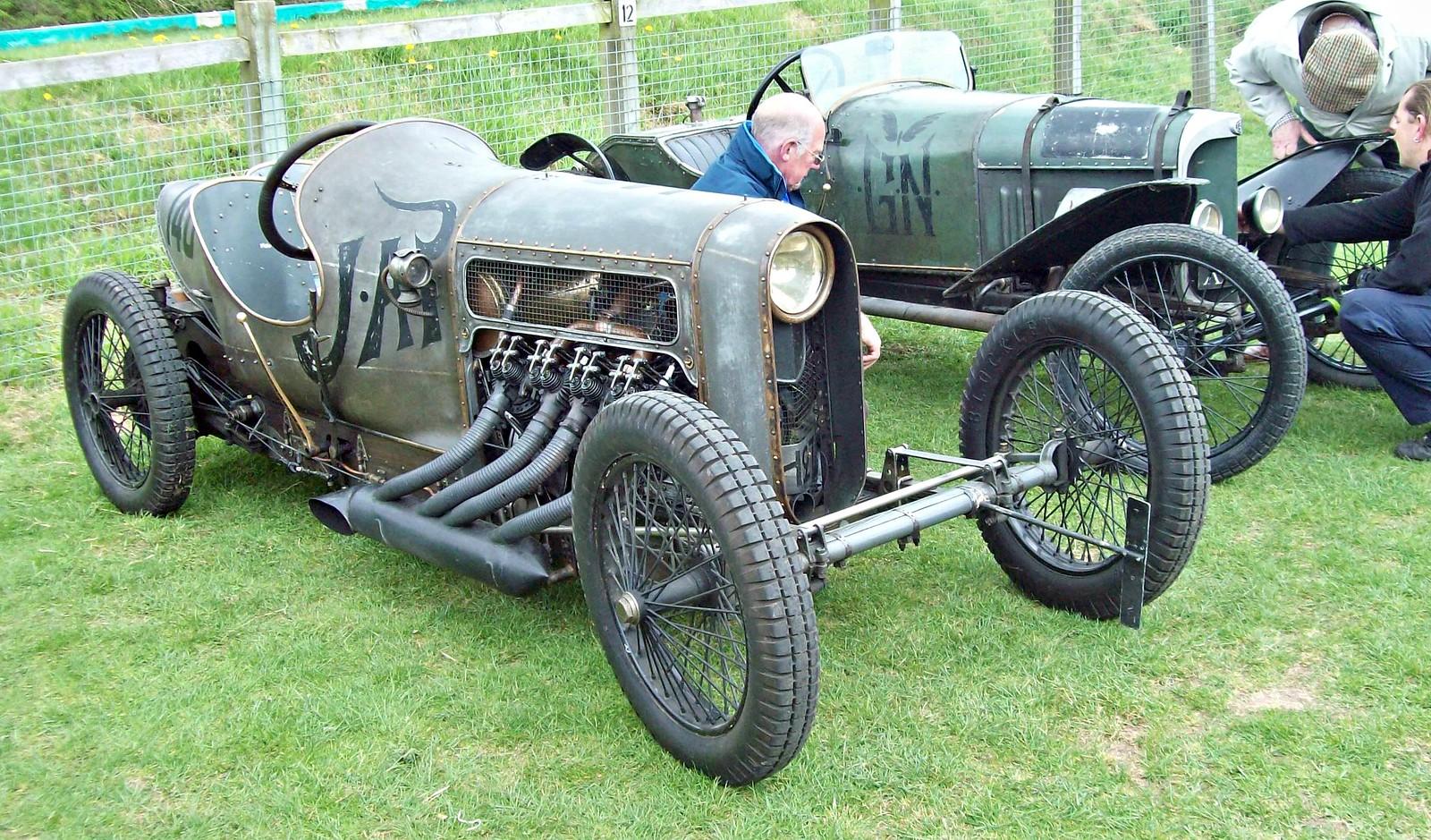

1910 Richard Scaldwell's JAP GN Grand Prix special with a J.A.Prestwich 5 liter/305 c.i. V8
25,347
Trouble with the olden days, it didn't matter whether dirt got in a engine because
machining, materials, and oils were poor quality. Engine covers & filtration were
down the list and pressure lube systems were not standard.
