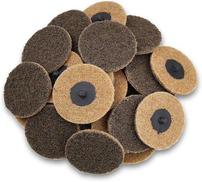

If you do your own next time, and you find dings, they need to be stoned down. What I mean is if the chrome is raised, it will cut the seal, then you will have a leak. If you stone it smooth, it will not cut the seal. I have been using an angle grinder with the roloc or 3m discs to smooth the chrome for years now with no problems.
Swetz
Oct 31, 2019
1,792
NJ/PA
Retired :-)
Roloc...We generally just call them cookies...LOL
