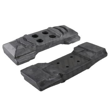

We have a handful of excavators with roadliner type track pads. One in particular is starting to shed some pads. We ordered a handful of pads to replace and received complaints from the operators that the "ride quality" sucks. It makes sense that it would as the new pads have a pretty decent height difference. My question I suppose is; What is worse? New pads next to old or missing pads in a few spots? Out of the 80 pads like a dozen have shed and about six have been swapped out. My concern is that the new pads next to the old are creating a lot more stress on the chains versus having a gap. I would like to just replace all of them but its about 7k$ to do so and the owner would like opinions from others in the field with more experience on this style track. I don't have a ton of experience with these so I would also like to know what the best practices are myself. Thoughts and opinions please!

Not really pavement specific application. Machine sees about a 50/50 mix. My biggest concern is the chains, rollers and sprockets. Now if the gap is the better option, how far can you take that concept? I also had someone suggest replacing every-other pad too. That seems like it would solve the ride quality issue but still leads to weird stresses.

Because those pads don't have holes in the centre (the one's I've seen) dirt tends to compact in the chain more that just conventional grousers. That doesn't do the chains or sprockets much good either. Depending on how hot the weather gets standard grousers don't the the pavement any harm if care is taken. That's been my experience at least operating diggers from 4 to 25 tonnes on roads. Heck even laying tyres down does more damage.

My experience with road liners has been **** poor. They always delaminate. And with allen pad bolts, I can never keep them tight.
I ended up using bolt on pads, after burning 4 holes in every triple trouser.
Don't even think about clip on pads, either.
I put bolt on pads on my 4 314, 2 320, and 3 328 Cats. And never looked back.
The road liner failures were in a Cat 314, and my Komatsu PC128UU and PC228UU.

Just so everyone is on the same page. This is the type of pad I'm dealing with. Its not a cleat or clip on design. This is a John Deere 75G with 3000 hours. Also I'm not looking for quotes or sales pitches. Looking for best practices in replacement cause and effect.
So far the one train of thought is your better off leaving an empty slot versus a new single shoe. I can get behind that as being better for the surface your working on. What would be the percentage missing to prompt replacement?

I'm on the same page.
All road liners delaminate before wearing out.
As for mixing heights, the additional stress/ wear and tear on the rest of the undercarriage will be negligence, if not non existent.
You've got an 18k lb machine, with a 5.3psi ground pressure. Adding one, or several, new road liners to the existing ones won't change enough to even begin to worry about.

At the above price quoted, it may be better to just replace them all if the operator is complaining of a rough ride.

I'm completely aware that they will fall apart before wearing out. Just have to deal with the operator complaints then....LOL
