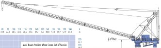

One day, I recalled a critical piece of detail from my childhood: the trolley tower crane I witnessed, it looked like it was displaying the word "COUPAL" on it's turntable base and blue counterweights in addition to it's blue and white paintwork. And sure enough, BOOM! I found it! A Pecco SK 170!Pecco SK 170 dimensions.jpg
Then, out of blind luck, I found another Pecco crane, which, SPOILER ALERT, is most likely the crane that appeared in Spider-Man 3: a CGI modeled and modified version of the Pecco SN 355.
But yes, that crane you see in Mighty Machines, the first luffing crane, is most likely a Pecco SN 160-16. I can't believe I finally identified the "mystery luffing" tower cranes of my past! These tower cranes are like RELICS to me!
But now, I need help to identify THIS ONE (the crane named Carmen):
With all the information I've gathered so far, I'm 50% convinced it's either a PECCO or PENIER luffing tower crane! I feel so close to victory! What I know about this luffing crane is it sports blue and white paint, has a single hook block on a single leg cable, it's boom is operated by a single cable also. It's counter jib also appears to resemble the counter jibs of most typical trolley tower cranes (note the apex it's connected to).

UPDATE
Look at the pics below:
After reviewing the Pecco SN 160-16 manual's parts and pieces, I noticed an intriguing clue: A-frame. That's the name of those steel frame things that sit on the counterjib of the SN 160-16.
15:53
Again, the Pecco SN 160-16 is what Skyhook is. But after searching up "non a frame luffing tower crane", I caught a diagram with another interesting and game-changing clue: Cat Head. That's the synonym of apex or tower peak.
So basically, Carmen is some kind of luffing tower crane with the following characteristics: a counterjib attached to the cat head via two rear pendants, a cylindrical load block hook on a single leg cable, and a single boom cable. Blue and white paint on the frame assemblies with what looks like "ELLIS-DON" as it's logo (if "ELLIS-DON" is even a still operating company).
This is Carmen viewed at a different angle.
But yes, with these new clues, it should help cut down our suspects lists and narrow down our search easier.

I did manage to find some other luffing boom tower cranes with this similar A-frames and counter jibs. but sadly, all hopes for netting the manufacturer behind this type of tower crane design is turning up fruitless.

What you are calling and A-frame I've always known as a gantry. Another term you might run across might be a queen post but those are usually found on huge crawler cranes with a straight boom and a luffing jib on top of the straight boom. You might try adding Link-Belt to your search for tower luffing cranes. I've been told by some people at an auction company that those were specced on a project they worked some years ago in New York city.

I just recently found more images to back up proof, but as always, manufacturer name/decal or model number... fruitless.

So here, initial assumption: Pecco - due to the signature paint. But after browsing Google Images (of tower cranes in Toronto (due to the city it frequents)), newly discovered evidence taught me paint livery of machines can be manipulated to suit the contractor/company utilizing it.
E.G, this Link-Belt HTC 8670: it's now painted in CHAMPION CRANE livery. So a layperson's assumption: "Champion Crane". But overall, it's the shape and silhouette of the machine that will tell the full story behind it's identity.

Another brand name I saw out here today was a Potain. I don't know if they build luffers.
