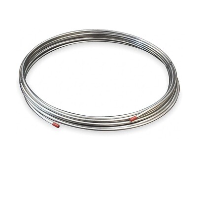

I found some 3/8"s stainless coil pipe on ebay and Amazon. I wonder if this would work with either tig'ed on ends or flared pressure type fittings. I also wonder how much of a pressure spike it could handle before blowing out.
You'd need to know the pressure rating. Beverage systems and stuff wouldn't be near to hyd. pressures.
I saw that it said beverage system also. I have seen the same item listed 4 different ways. One listing showed the pipe rated at 2500 psi. Not really sure what they are selling. Other than .20 wall thickness.
