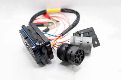

I tell you what you can do and I have done in the past. Create a harness that will power up the Engine ECU by itself and then start the machine. You'll get some wonky codes because the CAN data is disconnected but you'll be able to defer if it's a bad ECU or bad harness in between.
I can try to grab some pictures of the harness I have. An old times fixed it up for me and gave it to me. It's super helpful, will get you out of a bind.

Interesting definitely share if you find it! With your test harness are you powering it straight from battery?

Yes, with an on off switch. The sell some on the internet I'll try to find one so you'll have an idea. I'm sure there's a thread on here on how to make one. @Nige is probably the guy to have that thread ready.

Here's one that's similar. Obviously nicer than mine but exact same concept.
