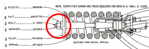

Somewhere In this dozers life, the spring that is suppose to be preloaded and under extreme pressure seems to be decompressed. ?!? The large nut and bolt that goes through the center of the spring is completely loose. You can actually wobble around the shaft freely inside spring.
I have concerns about the releaseing of the spring in its current condition. The spring itself appears to be completely intact and nothing that appears cracked. So I prefer to keep the spring in tact. How risky is the spring at this point. Best I can tell, there is no tension due to preload. ‘Again the bolt shaft is completely loose. If there is any pressure still there it would only be what’s there from the spring hold down brackets located in front of the springs. Those brackets which are two piece, each bracket with a total of 4 bolts holding those down. What precautions should be taken to prevent any dangerous conditions. I was thinking of several straps looped around the spring and a chain binder to connect to the frame while removing the brackets that will grant me access to the spring for removal. My hope is to remove the spring and so long as if it is still safe to use , I would like for it to be preloaded again and finishing up the seal repair.

There can be differences in the tensioning/recoil mechanisms between different models of D6D. It is important to get the correct one for your machine. The illustration below may or may not be correct.

That large bolt on the center of the spring os only for removal and installation purposes. After the spring is installed onto to machine and both dogs are bolted down to the track frame in front of it that bolt gets loosened to allow the spring to rest between the backing plate and the dogs. Unless there are broken bolts on the dogs or see any cracks or broken welds anywhere that spring should be perfectly contained. With that said they are still widow makers and should be treated accordingly. You could if you want wrap chains around it and the track frame. Those springs are very affordable aftermarket and readily available (at least the last I checked) so if you do decide to remove it just cut it one coil at a time until all tension is released. If you decide to go that route post back here before trying to compress and install new spring because you must compress it properly.
Oh wow this is interesting and makes me hopeful. so the fact that the rod is loose doesn’t necessarily mean it’s broken. There are no broken bolts on the dogs. Haven’t seen any cracks anywhere. To me nothing looks compromised concerning the spring. That loose rod is all I’m going by as the concern for the spring.
Hell it might be perfectly normal as it is.

Then the illustration I posted above is correct.
However the piston be ing stuck in the cylinder is what lead me down this rabbit hole. Any thoughts on removing a stuck piston.
Can you post a photo of the area circled in the illustration below. Are the end of the bolt, the washer, and the nut all still there.?
EDIT: Thinking a bit more about it the possibility exists that the piston is seized right at the back (left side as per the illustration below) of the the track adjuster cylinder and this is what has pushed the bolt to the left and has it hanging loose.?
