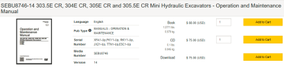

My question #1 - do you have an Operation & Maintenance Manual yet.?
If not, that should be your first purchase because alternative fluids are all listed there, along with a mountain of other useful information.
You can download a pdf copy for $75 from the Cat Pubs web site. Search for SEBU8746.
Alternatively here is something a bit cheaper (and older) from eBay. It is CHG02 where the latest version of the manual is CHG14.
