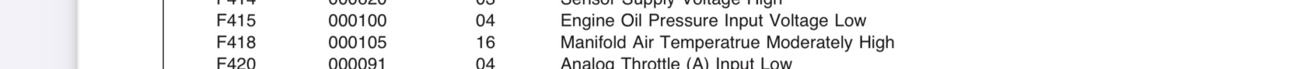

From what I see in parts , the machine has an engine oil pressure sensor not an oil pressure switch.
***Caution , The ECU pin out may not match the skidder***

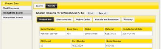

Your skidder is actually a 540G-III correct ?
The info I gave in the previous post is based on the machine sn # to engine serial number reference from the Deere Power systems site .
